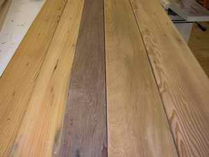

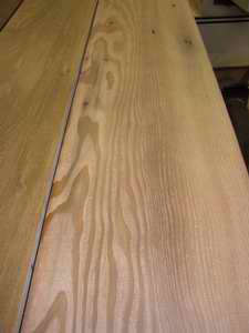

I have an opportunity to buy some really old cypress barrel wood which was used around the late 1800's to early 1900's. This stuff is extremely tight grained, rift sawn, and still has somewhat of a smell of pickles. I know there is one luthier who is building some really good guitars out of old whiskey barrel wood, but I have never heard of pickle barrel wood being used.
Is it any good for instruments? It is rediculously expensive and the widest piece is only 6" wide, so a 3 or 4 piece back would be necessary.
Anybody else interested in any of this stuff? Here are some pics. by the way, the wood has been planed and cleaned up in these pics.

But with that said, I wouldn't build a guitar with the boards pictured...
Just because wood is old doesn't mean it's good (especially if it smells like pickles and is expensive). At best you could split a piece and if there isn't much runout saw it to be quartered and have some back braces or possibly a neck.

I finally got through to my source tonight on this wood. He has placed about 200 brdft of it in a kiln and it has just come out. He says that it has no smell after it has been planed and has offered to send me a board of it, relatively verticle grained and wide, for shipping cost only to try out.
As soon as I get it and can resaw it, I'll send out a couple of sets for trails if it looks promising.

Ken, if those barrels were built east of the Mississippi, they're probably Bald Cypress (Taxodium distichum). The cypress preferred for Flamenco guitars is Spanish Cypress (Cupressus sempervirens), I think.
I built my barn entirely from bald cypress as most of the sawmills here in central Fl. cut cypress as opposed to Oak or Pine. You have to nail it up while it's green because it's as hard as a rock when it dries out. I cut up some 8" offcuts for back/side sets last summer that had been sitting around under roof for over 10 years. The grain is rather uninspiring but I've never seen a wood that bends so easily. If your friend is offering a free board for the cost of shipping, I'd say go for it.

True, that. Bald cypress and Spanish cypress are totally different. I had a customer send me some bald cypress thinking it would make a good guitar. The resonance is very dull. I talked him out of it.
Common names like cypress, pine, cedar are very misleading. Think of all the unrelated woods called "cedar" and you get an idea of the problem. Bald cypress is great for exterior applications like decks and outdoor furniture, but I would not want to build a guitar with it.
